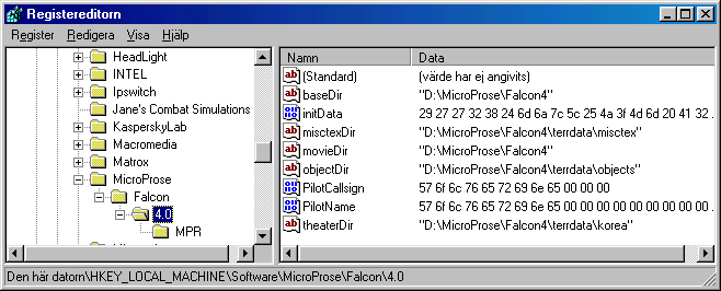

| Open
the Microprose folder.
Open
the Falcon folder.
Double-click
on the 4.0 folder.
Now
you will see this window:
(Note:
Ignore the initData, PilotCallsign and PilotName)
| Got
there? Excellent!
Now
it´s time you exported this folder.
It can be exported anywhere on your harddrive, just remember
where you put it!

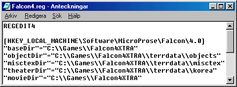

Now
you will see a Notepad window:
| These
command lines show where your original install of Falcon4 is
located.
Now
edit the command lines in the window to reflect where you
want to place your extra install of Falcon4.
Note: Beware of the double backslashes in the command
lines! They must be there.
Example:
You
want to have an extra install of Falcon4 at C:\Games\Falcon4XTRA.
The name should be different from your original install so
you can tell the regfiles apart.
You
copy the entire Back-up folder you created earlier that contains
Falcon4 patched to 1.08US to C:\Games.
Then rename the Falcon4 folder you just copied to Falcon4XTRA.
To
make the regfile for this install work you must also change
the command lines in the regfile to match the location of
your extra install. Remember that the double backslashes
must be there in the regfile command lines!
The
final regfile should then look like this:
