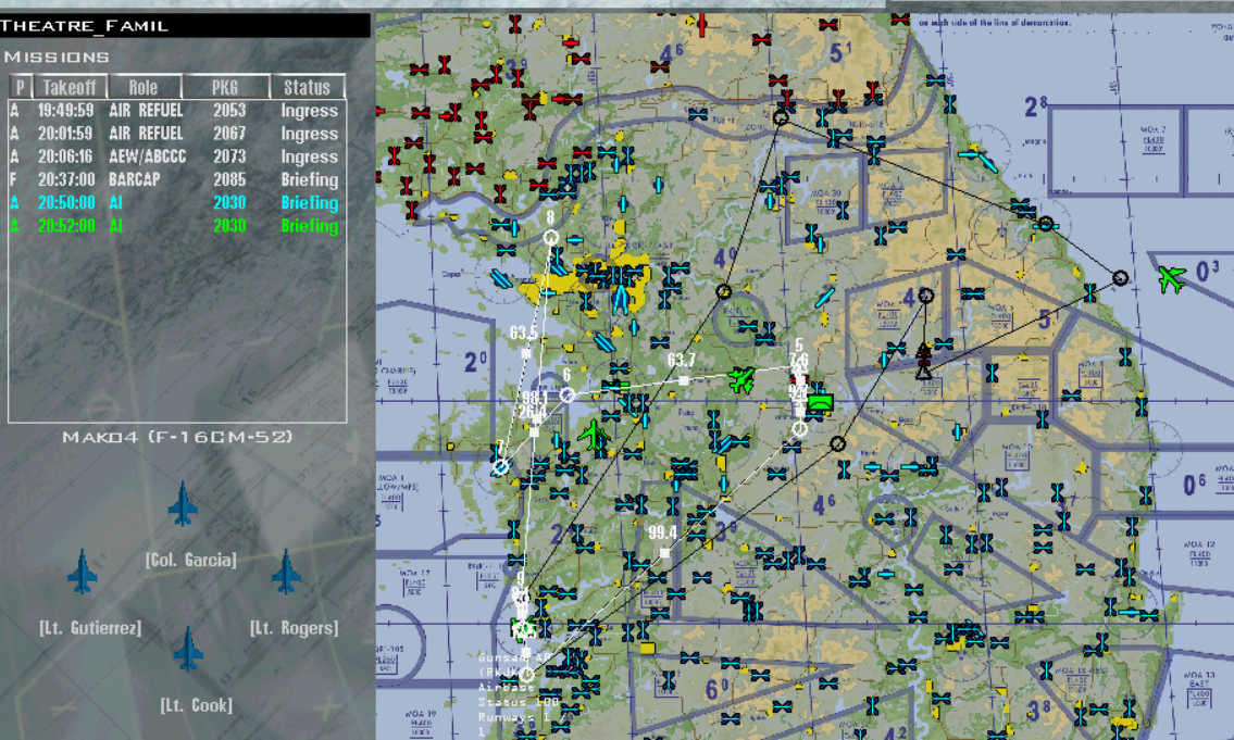

Gentleman,
Welcome back to Korea and congratulation on holding the line in your last campaign. While we have been away using the A model, our Block 52 have had some upgrades, time to test them out.
This will be a familiarization flight in KTO. Advice will be available during the flight on how to use the upgraded features.
Package
Banshee5 - 4 x F-16CCM-52 - Trg, Tcn 11/74 D/L 11-14
Mako4 - 4 x F-16CM-52 - Trg, Tcn 12/75 D/L 21-24
MS- No losses, all human controlled aircraft land safely.
PS - Max 2 losses, all other human controlled aircraft land safely.
Flight Objectives
Ramp - The flight will start at dawn. Ramp the aircraft and check out the external lighting control upgrades and new HMCS boresighting.
After take-off, refine your HMCS boresight then proceed towards the target, these are different for both flights but there is an Engineer unit around the target area. Practice finding these using the upgraded A2G radar and also try using the HMCS to mark ground targets. Each aircraft has 3x BDU-33 for practicing bombing these targets.
Once completed on the range there is a friendly Patriot missile system. You have one HARM loaded. In the DTC setup the ALIC code for patriot. There is another missile system nearby that you should detect on your RWR, again this is friend but practice coding the HARM in the aircraft to detect this SAM system. Note, DO NOT FIRE ANY HARMS, this is just to practice setting up the ALIC tables from the DTC and in the aircraft.
Once off target, proceed to the A2A refuel point (different for both flights). Practice the updated comms procedures and dust off your A2A refuelling skills. For anyone who doesn't want to do this, there is an airport nearby where you can land and hot pit refuel, although you will need to look up the frequencies.
Once off the tanker, do the g warmup exercise for g tolerance, re-boresight your HMCS then head up to the border and see if you can see any enemy aircraft on radar. Have a look at the upgraded Aim-120C DLZ with extended range. If the enemy gets within 40nm hot then you are cleared to engage. Note the radar modes used for missile DL will now effect where the missile is looking when it goes pitbull.
Once you've completed your border sweep, RTB with an OHB, fuel allowing.
Flight Leads in this Sunday's official mission, "4.36 KTO Mission 1" are requested to post a debrief of their flight's actions, including any lessons learned or that should be learned by others.
